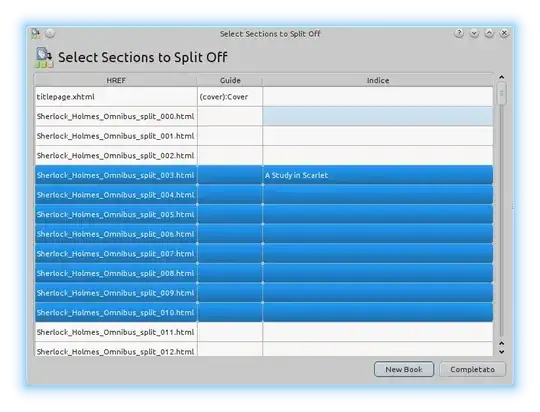

Besides using a real ebook editor like Sigil, there is an easier way to do it.
Calibre has a very useful additional plugin called EpubSplit, that with a simple interface let's you select the single .html files inside the .epub and create a new ebook just from them; after the process is also possible to edit the metadata of the newly created ebook.
These tools only work with .epub files, to perform this kind of editing on other formats a conversion with Calibre should be made.
