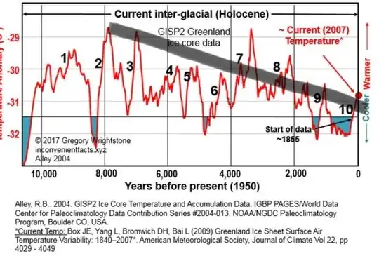

CO2 does NOT control Earth's Climate, it plays a role, but so do other factors., in it's long geologic and shorter term histories. It played a role when CO2 was 10x that of present. Even so we had an Ice Age during the Ordivician (4,400 ppm). Jurassic cooling period (1,700 ppm) The biggest influencer is the Sun. magnetic anomolies, sunspots, milankovitch cycles. Earth's orbit and axial tilt variation that permit More or less solar absorption.
For the last 800,000 years, Earth's ambient CO2 NEVER went up above 280 ppm average. In the last 10,000 years, we've had 20 major warming and cooling events and ambient co2 remained fairly constant.....
LazyReader
  • 739
    Downvoted. Doesn't answer question and misrepresents the current significance of CO2 to climate. CO2 is the single strongest cause of current climate CHANGE. It IS "controlling" the change to Earth's climate now more than any other factor, irrespective of other periods of climate change not being because of changes to CO2. The graph is very misleading - deliberately? One region only, not Global. Missing the full range of relevant data available that together does show the significance of anthropogenic emissions. And with the largest part of recent warming - post 1970s - missing. – Ken Fabian Oct 25 '21 at 20:52
  • 1 degree C in the span of 150 years is not a detriment. Nor is it indicative of widespread shift. The little ice age lowered average Temps 1.5 degrees with same ambient co2. Compare CET central England temperature which goes back to the 1650s to CO2 by year. Note Temp curve failed to obey the Co2 curve. 80% of all greenhouse gas emissions originated in the last 50 years. Tempsvdid not follow the same geometric rate.. – LazyReader Oct 25 '21 at 21:30
  • Your answer and comment are not consistent with current science based understanding of our climate system, it's history and current climate change. – Ken Fabian Oct 26 '21 at 23:40
  • The little ice age also hade four massive volcanic eruptions, co2 can't warm by trapping heat from sunlight if you cut down the amount of sunlight. we know what caused worming in the past and we know all of the factors except co2 are currently pushing cooling yet we are warming, co2 is literally overpowering the other factors. you mention several factors but fail to understand them. your graph is useless since it does not include co2. – John Oct 30 '22 at 04:09
