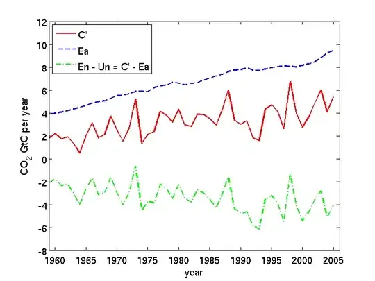

A rather late answer on this question, but here goes: The idea that "global temperatures cause the increase of CO2." is fairly easily refuted. The usual line of reasoning is that the solubility of CO2 in water decreases as temperature increases, so the rise in global temperature implies that the oceans will have released some of the dissolved CO2 that it contains. The premise is correct, but the conclusion is a non sequitur as it ignores the fact that the solubility of CO2 in water also depends on the difference in the concentrations of CO2 between the surface ocean and the atmosphere. As we have released CO2 from fossil fuels into the atmosphere, the partial pressure of CO2 in the atmosphere has risen, and so the oceans have been taking up more CO2, not less.
How do we know this is true? . The argument is easily refuted by the observation that the rate at which atmospheric CO2 levels are rising is less than the rate at which we are releasing CO2 into the atmosphere from fossil fuel use, which implies that the natural environment must be a net carbon sink, taking in more carbon each year than it emits.
More formally, let Ea represent annual carbon emissions from anthropogenic sources (fossil fuel use and land use change), En represent the carbon emissions from all natural sources (the oceans, soil respiration, volcanos etc.) and Un represent the uptake of carbon by all natural carbon sinks (oceans, photosynthesis, etc.), Ua would be the uptake of carbon due to anthropogenic activities, but this is essentially zero, so we can safely exclude it from the analysis. Then assuming that the carbon cycle obeys the principle of conservation of mass (any carbon emitted into the atmosphere that is not taken up by natural sinks remains in the atmosphere), the annual change in atmospheric CO2 is given by:
C' = Ea + En - Un
This can be rearranged to give an estimate of the difference between annual emissions from all natural sources and annual natural uptake by all natural sinks.
En - Un = C' - Ea
We have accurate, reliable data for the growth of atmospheric CO2 and for anthropogenic emissions (for details, see Cawley, 2011). Both of these are displayed below, along with an estimate of the net natural carbon flux En - Un. The fact that the net natural flux is negative clearly shows that natural uptake has exceeded natural emissions every year for the last fifty years at least, and hence has been opposing, rather than causing the observed rise in atmospheric CO2.
source
