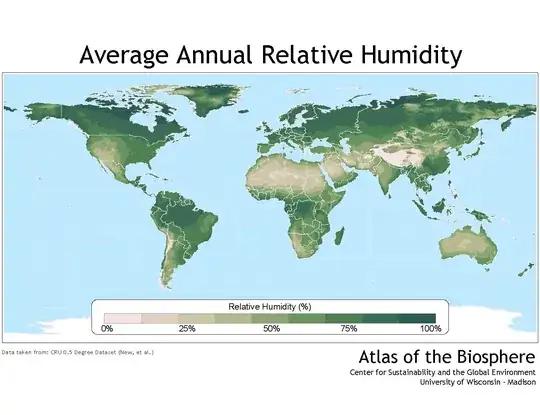

Average relative humidity over land varies quite a bit. Notice the cold regions and regions over rain forests tend towards high humidity. Climate change may increase the lighter areas of lower humidity.
https://nelson.wisc.edu/sage/data-and-models/atlas/maps/avgannrh/atl_avgannrh.jpg

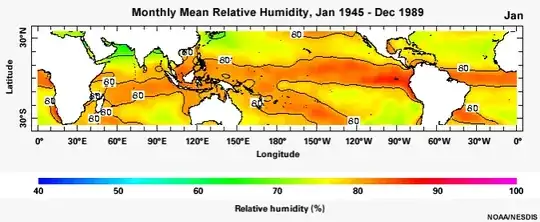

Humidity over oceans tends to be higher, closer to 100% all the time
http://www.goes-r.gov/users/comet/tropical/textbook_2nd_edition/media/graphics/jul_rel_humidity_static.jpg
