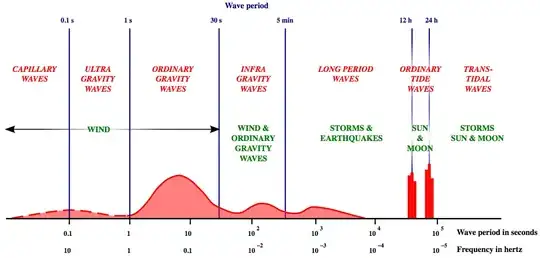

Long answer: Tsunamis are often called 'tidal waves' to highlight the idea that their characteristic time response is closer to tydes than to the standard wind waves we are used to see in a beach. The full spectrum of water wave periods is shown in this figure (tsunamis being classified as long-period waves, together with waves caused by meteorological events): enter image description hereClassification of the spectrum of ocean waves according to wave period. Redrawn from Figure 1 in: Walter H. Munk (1950) "Origin and generation of waves". Proceedings 1st International Conference on Coastal Engineering, Long Beach, California. ASCE, pp. 1–4.
This image shows that the wave frequency depends on the cause behind the perturbation of the water surface.
