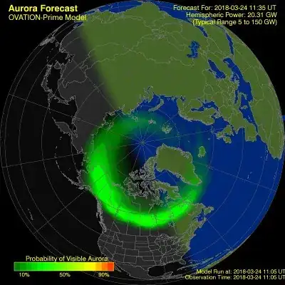

Magnetic reconnection is responsible for the displays that people usually think of as the Northern Lights. The brightest aurorae typically occur on the auroral oval around midnight Magnetic Local Time (MLT). This can be seen in the results of the current OVATION model below. OVATION model of the northern hemisphere aurora 2018-03-24 11:35UT, courtesy NOAA.
The energetic electrons that cause the bright midnight aurora are generated by reconnection in the magnetotail, the portion of the Earth's magnetosphere that streams behind the Earth, dragged by the motion of the Solar wind (this is briefly mentioned in the NASA youtube videos linked in the question). We can tell this from the fact that the aurorae occur in a distinct oval around the pole.
