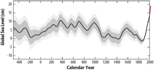

This article based on 2016 publications shows a global decline during 950 to 1250. enter image description here
Fig. 1 Reconstruction of the global sea-level evolution based on proxy data from different parts of the world. The red line at the end (not included in the paper) illustrates the further global increase since 2000 by 5-6 cm from satellite data.
There may be local differences due to isostatic rebound but these happen on much longer timescales.
