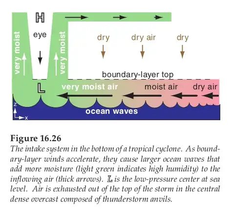

For a quick hint at the Stull treatment, I include a figure from his text showing the intake system of the tropical cyclone in schematic cross section. This nicely illustrates that the majority of the updraft air coming up the walls of the eye diverges at the top of the core, rather than subsiding down the core (see text):
Fig 16.26 Intake System Tropical Cyclone

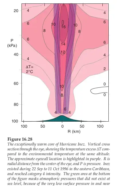

Also, a figure from Stull showing the difference in temperature within the hurricane core relative to surroundings:
Fig 16.28 Core temperatures hurricane relative to surroundings
That perhaps makes it more sensible that the warmer core air cannot continue subsiding down to the near-sea surface low at base of the core, where the air is very moist, but at lower temperature (might consider this to be a high stopping on encounter with a low).
