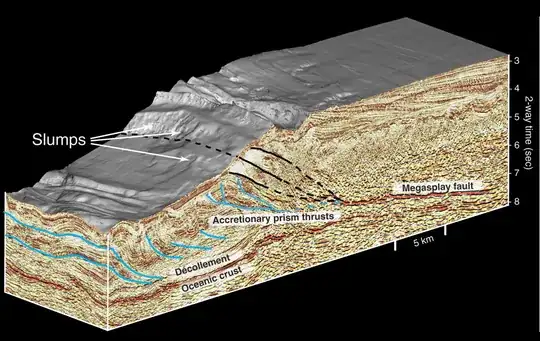

From thousands of field recordings, usually shot in a grid over a land or marine area, we can reconstruct an image of the subsurface using a process called tomography. The data might be 2D (a vertical cross-section) or 3D (a volume, analogous to a CAT scan). In some cases, this image is excellent and reveals a great deal about the geology of the region. Here's an example from a paper by Moore et al. (Science, November 2007):
Moore et al seismic image
How much can you see?
A large survey might be hundreds of square kilometres, or many tens of kilometres long in the case of 2D data. We can image well down to about 6–8 km, and we can image something down to about 20 km. The typical resolution of seismic is on the order of tens of metres horizontally and a few metres vertically (about a quarter of a wavelength). This is much better than gravity or magnetics. You might think, "Why not use higher frequencies for imaging — surely you'd see more?" Yes! We would love to use ultrasound (say) for imaging. The problem is that high frequencies are absorbed more efficiently by the medium (mostly rock and water) and actually heat it up very slightly.
