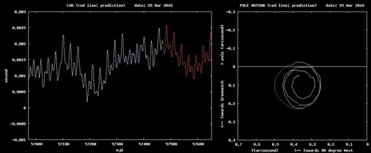

The rotational pole moves continuously, as you can see from the right-hand side of this figure (below) by the Earth Orientation Centre (EOC) and the International Earth Rotation and Reference Systems Service (IERS). The figure shows about 650 days of time; mjd is modified Julian day and time goes along the locus in the polar motion diagram.
The daily polar motion
The left-hand side of the figure shows Length of Day, and I think that's chiefly why they are making these refined polar measurements — to keep track of leap seconds, etc.

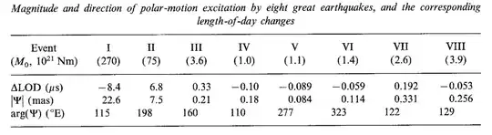

It's been established, by Fong et al. (19996), among others, that earthquakes could change the earth's rotational axis, by redistributing mass on a large scale. Their table 1 shows [the sort of effect that individual earthquakes theoretically have — edited after comment from David Hammen] on the length of day; $\Psi$ is the excitation vector:
Table 1 from Fong et al 1996
