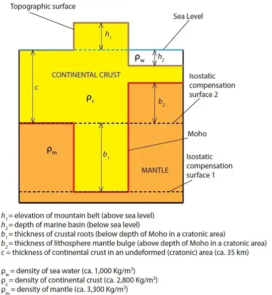

The elevation of continents is generally thought to be the result of the isostatic equilibrium (Archimedes balance) of the crust floating on a fluid mantle (Pratt and Airy models, late XIX century). The thicker the crust (which is less dense than the mantle), the higher topography. The denser the crust, the lower the topography.
Cartoon explaining the concept of isostatic equilibrium, according to which topography (h1) is sustained by a crustal root (b1) in the same way that the elevation of an iceberg reflects the size of its submerged part.
