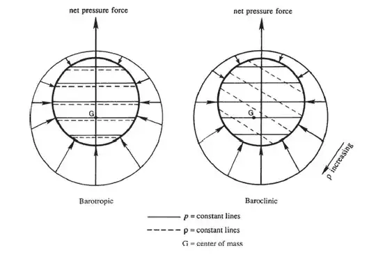

Barotropic flows are those for which the fluid density $\rho$ depends on pressure $p$ only, i.e. $\rho = \rho(p)$. For example, constant density, isothermal, and isentropic flows are barotropic. Baroclinic flows are flows that are not barotropic. In this case the fluid density depends on pressure AND temperature, salinity, constituent concentration. Heavy fluid sitting adjacent to lighter fluid will sink and rise, respectively.
These flows are said to be baroclinic, meaning pressure breaking.
Consider the two fluid elements below. In the barotropic case, lines of constant $p$ are parallel to lines of constant $\rho$ so there is no mechanism to generate vorticity. On the other hand, in the baroclinic case, the lines of constant $p$ and $\rho$ are not parallel. The latter arrangement give rise to changes in vorticity $\vec{\omega}$ and circulation because the net pressure force no longer passes through the center of mass of the fluid element.
Seen another way, take a look at the vorticity equation with density variation:
$$\frac{D\vec{\omega}}{Dt} = (\vec{\omega}\cdot \nabla)\vec{u} + \frac{1}{\rho^2}(\nabla \rho \times \nabla p)$$
The cross term on the right hand side is the baroclinic torque. When it is zero the flow is barotropic whereas if it is nonzero the flow is baroclinic.
