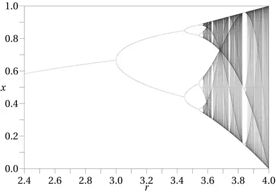

Bifurcation is a characteristic of chaotic systems. To quote the Wikipedia article on chaos theory
Chaos theory studies the behavior of dynamical systems that are highly sensitive to initial conditions—a paradigm popularly referred to as the butterfly effect. Small differences in initial conditions (such as those due to rounding errors in numerical computation) yield widely diverging outcomes for such dynamical systems, rendering long-term prediction impossible in general. This happens even though these systems are deterministic, meaning that their future behavior is fully determined by their initial conditions, with no random elements involved. In other words, the deterministic nature of these systems does not make them predictable.
The climate of the Earth is one of these chaotic systems. What happens at a bifurcation point in a chaotic system is that a tiny change of the input parameters to the model results in an entirely different outcome. For this reason it is important to understand the bifurcation points of the system in order to understand when your model has no predictive power.
The most classic example of a chaotic system which exhibits bifurcation is the logistic map. This equation is used to model demographics or population growth in biological systems.
$$ x_{n+1}=r x_n(1-x_n) $$ The outcomes of this equation for different values of the parameter $r$ are shown in the plot below (taken from the Wikipedia article cited above). You can see that after $r$ goes over $3$ the outcomes of each successive iteration become completely unpredictable. The first two bifurcations in this example are at $r=3$ and $r=3.5$.
