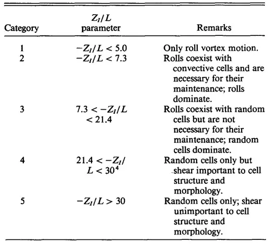

Using the example of a marine layer, if $Z_l$ is the boundary layer height, the dominant eddy structure (roll vortex motion, free convection or both) can be estimated with the parameter $-Z_l/L$ (its absolute value measures the stability of the boundary layer). Some common values categorizing the dominant eddy structure and morphology are given in (2). A summary is found in the table below:
