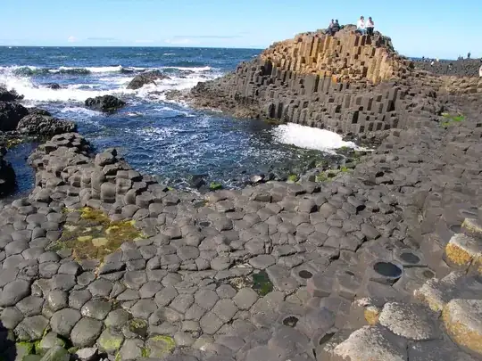

The Giant's Causeway is, according to the Wikipedia page was formed during
during the Paleogene Period, Antrim was subject to intense volcanic activity, when highly fluid molten basalt intruded through chalk beds to form an extensive lava plateau.
Of particular note is the distinct columnar pattern (as seen in the picture below):
Formed, according to the Wikipedia page by
As the lava cooled, contraction occurred. Horizontal contraction fractured in a similar way to drying mud, with the cracks propagating down as the mass cooled, leaving pillarlike structures
What was the geochemical/petrology process(es) cause the contraction features that resulted in the columns being formed in the Giant's Causeway?

These are basalts with columnar joints. Basalt is an igneous rock that forms when magma (liquid + crystals) erupts onto the surface as a lava flow or gets injected into cooler shallow crust and forms an intrusive dike or sill. Because basalt cools quickly, basalt commonly contains glass as well as crystals. The physical properties of magma changes rapidly as it cools through the liquid-glass transition temperature. When a magma cools through the liquid-glass transition temperature, its specific volume decreases and its viscosity increases rapidly. The volume of the lava flow decreases (it shrinks) and it become more viscous and brittle. This creates stresses in the lava flow that eventually causes it to fracture. Columnar joints are fractures that have formed because the stress has exceeded the brittle strength of the rock.

In fact, columnar jointing like this is common in nature and also appears in other rock types all around the world, especially in other lavas, subvolcanic intrusive (i.e. dikes, sills, laccoliths) igneous rocks, and welded tuffs/ignimbrites, but also in sandstones (in the case of sandstones, they are nearly always associated with heat transfer from nearby magmatic intrusions—note: please ignore the unscientific BS about “plasma” in the previous link—I linked it solely for the great photos of columnar sandstone, which are hard to come by).
In the case of columns in lavas and other igneous rocks, tensile stresses develop parallel to the cooling surface, and in the case of sandstones, they develop parallel to the heating surface. In the case of lavas, these stresses develop as the lava or magma slowly and progressively cools from the outside-inwards, because solid, cooled rock is denser than liquid and hot rock. Stresses develop in columnar sandstones because sandstones are porous, which allows the passage and presence of water within them, and this water is heated by underlying igneous intrusions causing hydrothermal circulation and convection to occur.
Many igneous intrusions and lava flows are tabular in shape, which results in regular, extensive colonnades, but many times you will also see columns that are oriented radially, for example, in a former volcanic conduit or neck, because the cooling surface was cylindrical, around the walls of the conduit, oriented horizontally, in the case of vertically emplaced dikes, or every-which-way, for example, when columns form in a lava flow that fills an irregularly-shaped valley, or in subglacial eruptions, where the lava has irregular ice-marginal contact. The important point to realize here is that the tensile stress is always parallel to the thermally-contrastive surface, and so joints develop normal to that surface.
These columnar joints begin forming from existing cracks on opposite surfaces of the rock layer. As the cracks develop, and they develop sequentially, bit by bit—the size of that bit determined by scaling laws that relate to the spacing of the joints and the strength of the rock (ultimately this forms secondary lines called striae across the columns, I won’t get into this, but check out the Phillips et al. and Goehring & Morris papers linked at the end for the detail)—and each time they crack, the direction of the crack changes slightly, guided by the tensile stress field that permeates the rock (again, from thermal energy). At the beginning of the process, these joints are immature, and the degree of hexagonality is very low—the columns may start out irregular, of many shapes and sizes, with curved sides even. But gradually, over a large region where these tensile stresses are acting equally on the rock (for example, a large sill or lava flow cooling at the same rate, or a tabular body of sandstone with uniform porosity over a sill), the joints develop and mature, tending towards the most energy-efficient configuration. This same process occurs when corn starch dries, by the way—you can watch the maturation of columns actually occurring in this video.
This happens to coincide with a geometric construction known as a Voronoi tessellation. Essentially, the center of each column becomes the center of a Voronoi polygon, which is defined by sides which are equidistant from each surrounding other center of every other polygon. And the most efficient distribution of Voronoi polygons is all hexagons, spaced equally from one another. Therefore, if all other factors (permeation by precipitation, mineral changes, groundwater, irregular surfaces, internal cavities and fractures, etc) were able to be ignored, if a basalt flow could be allowed to mature infinitely, it would always tend towards perfect hexagonal columns. Of course, in nature things are not perfect, and basalt flows don’t have infinite joint length to spare or infinite time to cool, so eventually the columns are left in whatever state of maturation they ended up in. Typically that looks like mostly 6-sided columns, but with plenty of 5- and 7-sided columns, and a few 4- and 8-sided columns. Watch a Voronoi tessellation mature in this video (white-to-yellow-to-orange indicate hexagons—the whiter they are, the more regular in shape, while orange and blue indicate non-hexagons)

We (myself and three other geophysicists) had a somewhat heated discussion about this a few weeks ago. The best solution we could figure is that the columns were formed simply by contraction Fine cracks formed at the surface of the flow to begin with, and as these cracks formed they provided additional surface for the lavas to cool - so the base of the cracks could cool quicker than the centre of the budding pillar, in turn contracting and propagating downwards. Our best guess for the shape is some heterogeneity in the basalt - the shapes vary from three sides to about eight, so it's not consistent across the whole body. In terms of what "processes" caused the contraction, just the exposure to air/water would provide enough temperature to cause cooling of the fresh basalt.
It's also worth noting that a large extent of the Antrim flood basalt isn't columnar, so the Causeway (and a few other areas) had just the right amount of cooling.
