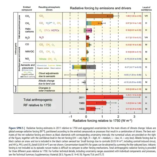

The IPCC AR5 figure of Radiative Forcing components attributes 1.65 W/m2 to the actual increase in CO2 concentrations from 1750 to 2011 (or ~1.3K in temperature rise, if lambda is 0.8).
IPCC Summary for Policy Makers from IPCC AR5
The values of Radiative Forcing that IPCC provides are likely close enough for doing realistic scenario testing. However, something in an entirely different feedback regime would need very different parameters. For instance, halving the CO2 in the atmosphere would have a much greater absolute effect on temperature than doubling it; temperature increases logarithmically as CO2 concentrations increase. This is because strong CO2 absorption bands are nearly saturated under present conditions, and increasing CO2 from present conditions mainly affects the flanks of the absorption bands. However, water precipitates out of the system easily under low-temperature conditions, so CO2 has a much greater forcing value in those types of climate regimes.
