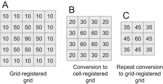

So what's the difference? The grid-registered version puts the data points at the grid corners (the red lines, not the grey squares, define the grid boundaries. You have to imagine the grid cells in the left-hand image). So if there are $n \times m$ grid cells, there are $(n+1) \times (m+1)$ data points in the grid-registered data.
Since there are fewer data points in the cell-registered version, making it involves some smoothing (averaging) of the values in the grid-registered version. There's an illustration of this effect on the other page you linked to; notice how the centre cell of value 90 ends up being smoothed away:
Flattening grids
So if accuracy is paramount, you should use the grid-registered version.
