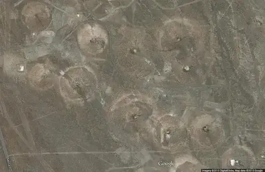

As you can see at the pockmarked Nevada Test Site, nuclear weapons really don't make much of a dent by comparison — these craters are about 200 m across:
Nevada Test Site craters

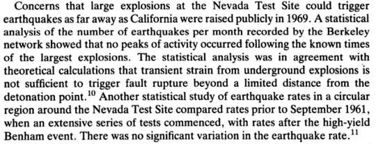

One might expect that a large explosion could cause an earthquake, but there's no real evidence for that either. Here are Goldblatt & Cox (1988, Oxford) in Nuclear Weapon Tests: Prohibition or Limitation?
Goldblatt & Cox excerpt
Note that we're not talking about triggering surface waves that a person might feel — nuclear explosions definitely do that. This is about causing a fault movement or rock fracture. Goldblatt & Cox are saying that the explosive strain is too small and too transient — that is, temporary.
