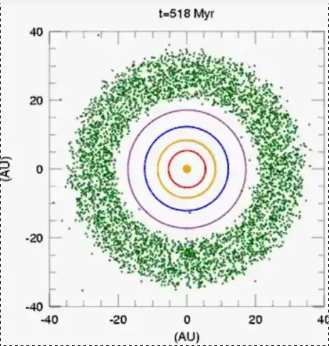

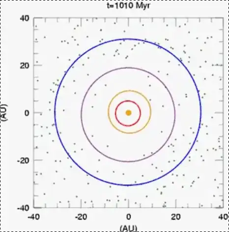

  3. Saturn moves outward and Jupiter moves inward. A chain of events happens, where Neptune and Uranus are dramatically moved outwards, with Neptune being chucked to the rear (and the hypothetical 5th giant being ejected). You can watch the video given in that question here.
Here are the before and after pictures, stolen borrowed from that question:
I can, specifically, recommend the papers I mentioned there: Fassett & Minton (2013), Deienno & Nesvorny (2014), Brasser et al. (2009), Nesvorny (2011), Nesvorny & Morbidelli (2012), and Gomes, Levison, Tsiganis and Morbidelli (2005) - in no particular order, I think.
