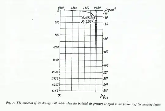

  2. Inclusion of air
    Googling for pressure ice density the (my) first search finds Density of glacier ice at the International Glaciological Society. This focuses on air in glaciers making the density lower, and concludes that at larger depths we reach that 0.92 limit:
