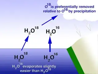

This is somewhat a general answer. According to the Royal Chemical Society webpage Chemical climate proxies (Evans, 2013), the rarer and heavier $\ce{^18O}$ isotope in water generally evaporates after and condenses (and precipitates) out earlier than the lighter and more common $\ce{^16O}$ isotope, shown in the diagram below:
Source: University of Michigan's page Past Climates on Earth
The colder the environment, the quicker the atmospheric water vapour condenses, hence the quicker the $\ce{^18O}$ isotope is depleted, giving a lower ratio of $\ce{^18O}$ to $\ce{^16O}$ (referred to by the RSC page as $\delta{\ce{^18O}}$) by the time it reaches the poles. In contrast, a warmer environment would mean that the water vapour condenses later and slower, meaning that less $\ce{^18O}$ laden water vapour condenses, resulting in a higher $\delta{\ce{^18O}}$ value.
In short, it is not so much of the amount of $\ce{^16O}$, but rather the ratio of $\ce{^18O}$ to $\ce{^16O}$ isotopes present, otherwise known as $\delta{\ce{^18O}}$.

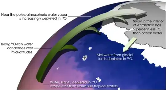

The following Earth Observatory diagram demonstrates the present-time process, showing the differences between warm and cold environments:
Source: Earth Observatory's page: Paleoclimatology: The Oxygen Balance
  • Thank you for such a detailed answer. Yes, I know it's O16 to O18 ratio that matters. So as far as I understand, more O18 in ice (in ice core) means that climate was warmer at the time ice formed, right? – amorfis Jan 28 '15 at 08:20
  • @amorfis yes, that is pretty much correct. –  Jan 28 '15 at 08:22
