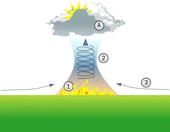

The general idea of how pyrocumulus clouds are formed is quite well known, and its relationship with a 'firestorm' is, in a simplistic way, is shown below:
Caption: Firestorm: fire (1), updraft (2), strong gusty winds (3) (A) pyrocumulonimbus cloud.Image source
