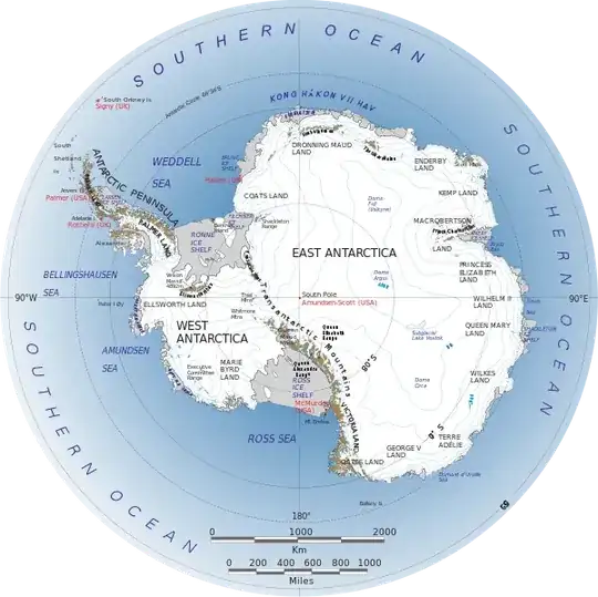

The West Antarctic Rift exists between the Trans-Antarctic Mountains and Marie Byrd Land (see map below for reference)
Image source: NASA
The rift system is believed to be like the East African Rift, consisting of several interconnected rifts, many are believed to be inactive.
However, the Wikipedia article vaguely mentions:
it is now known that West Antarctica is moving away from the East Antarctic Craton in a north/northeasterly direction (approximately in the direction of the South Georgia Islands) at a rate of about 2 mm per year or 500,000 years per kilometre.
What evidence is there for active rifting in West Antarctica?
