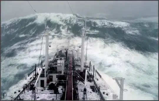

A rogue wave is, according to NOAA, "a large, unexpected and dangerous" oceanic wave. These are also known as 'killer' or 'freak' waves and have been a part of folklore of the past and observation of the present - such as in the rather terrifying example below (from gcaptain.com:
Caption: A wall of water approaches the Stolt Surf in Oct. 1977 Photo: Karsten Petersen, www.global-mariner.com
