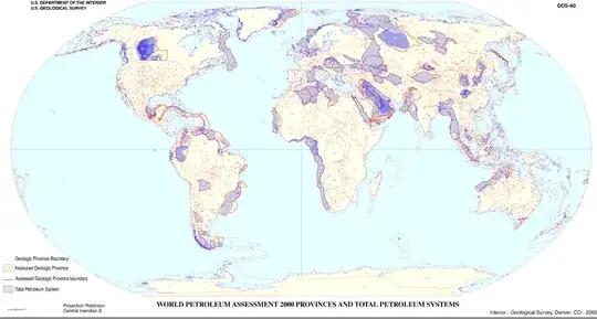

I wouldn't say there's 'almost none' in Europe, but the global distribution of petroleum is uneven. The reason is that petroleum systems need a convergence of conditions that is relatively rare.
For a start, the comment about the inappropriateness of a political map for this purpose is spot on. This USGS map of global petroleum systems, and non-petroleum-rich basins, is much better — apart from the fact that it perversely omits the USA's substantial endowment:
World petroleum systems
These 'petroleum systems' are essentially modern or ancient sedimentary basins with a particular combination of features. I'll refer to a previous answer about a specific region: Why would there be no hydrocarbons in the Sveconorwegian belt? Paraphrasing, and self-plagiarizing, here's what you need for a hydrocarbon (oil or gas) accumulation:
  • A kerogen-rich source rock that has been 'cooked' to thermal maturity. So you need lots of organic matter, burial, and time.
  • A migration pathway from the source to a trapping configuration, and time for this to have happened.
  • A structural or stratigraphic trap, such as an anticline, and the geological conditions that have preserved it since filling.
  • A reservoir rock — a porous and permeable rock. Usually this is a sedimentary rock (like sandstone, which there's lots of in Saudi!).
Only 'conventional' hydrocarbon deposits, such as you might find in the North Sea, Saudi Arabia, or the Gulf of Mexico, need all these conditions. 'Shale gas' is basically just a mature source rock — we can extract hydrocarbons from it by fracking, for example.
So the map of global petroleum resources is a map of places where these criteria converge. Certain deltas are prolific (Mississippi, Niger), because you have rapid burial of sand and organic material. In other places, one or more of the conditions has not been met. Much of Canada, for example, is exposed basement granite: none of the components are there.
The unevenness is exacerbated by the Pareto distribution of system productivity — as with most natural things, we have a few giants, and a long tail. So the WCSB and Saudi stick out as anomalous, making the distribution even more 'lumpy'.

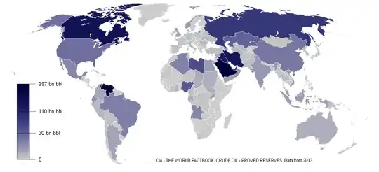

The map shown in the question is of proven oil reserves that can be extracted under current conditions. However, it is really showing you the distribution of oil reserves in a political sense, which is not fundamental to the source of petroleum reserves. Instead, you should look at the geology that is responsible for oil reserves. I like the description here: http://large.stanford.edu/courses/2013/ph240/malyshev2/
Regions where the ancient precambrian igneous rocks are exposed at the surface of the Earth are called shields. The world oil reserves are not found in the shields but in orogens which are regions between tectonic plates that experience deformation forces due to the motion of the plates. These forces create basins: areas of deep sedimentary rocks which are necessary to produce the oil. The forces also deform the sedimentary rocks which leads to creation of traps necessary for oil and gas accumulation. The basins and orogens coincide with many oil reach regions: east and west costs of America, around the Persian gulf, along the Ural mountains, across the Caspian sea, in Siberia, in the north of Africa.
