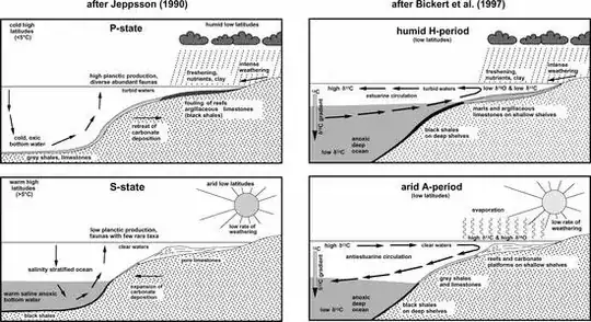

Recent research from Munnecke et al. 2014 (1) suggest that the carbon (and oxygen) isotope excursions that mainly affected low latitude palaeoenvironments, were probably due to climatic shifts between humid (low C) and arid (high C) climatic conditions. The possible consequences of these two climate regimes is shown below:
