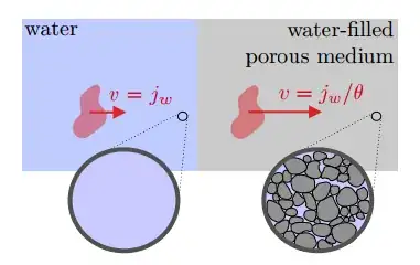

We find ourselves in a porous medium, so we will have always some volume filling factor $\Theta$ of water in rock.
enter image description here (copyright K. Roth, Heidelberg University)
Then we can start with the hydraulic conductivity, that can be defined as $$K = \frac{\Theta \left< \kappa \nabla P \right>}{\mu}$$ Here we have quite some notation to clarify:

The pragmatic approach is usually to simply state Darcy's law $$ q = - K \frac{dh}{dz} $$ relating the water mass flux $q = \rho v$ to the gradient of hydraulic head. We see now that a flow velocity will result from a pressure gradient, but strongly modified through the microscopic properties encapsulated in K.
The hydraulic diffusivity you search for is then written as $$D = \frac{K}{S}$$ where S is the water storage fraction, with $S \sim \Theta$ (not strictly correct). So in a way this just cancels the $\Theta$ in $K$ and appears in the pressure diffusion equation: $$ \partial_t P = D \Delta P $$ and therefore D gives the local diffusion speed of pressure disturbances (which is interestingly not the speed of sound $c_s$ in aquifers!)
We could now say, for educatory purposes that the difference between $K$ and $D$ is only $\Theta$. This makes sense when we look at the context where those two parameters appear: $K$ gives the strength of mass-flow for the fluid, the better filled the volume is, the more mass will flow.
Pressure, however does not care for the amount of water that flows, as it exists everywhere where water is sitting at a given moment, so the coefficient for its propagation does not depend on the filling of volume.
