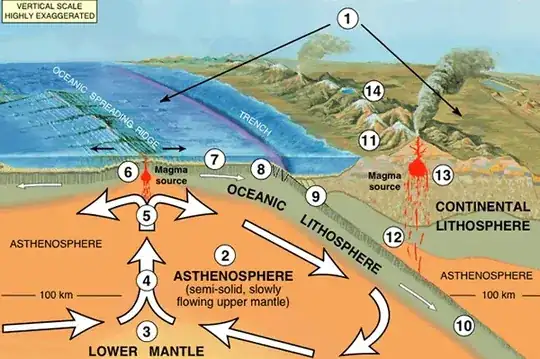

We have a reasonably good idea of what mechanisms cause varying rates of plate tectonic movement. First though, the overall mechanism is postulated and generally accepted as being due to mantle convection, as summarised in the diagram below:
Image source: USGS
Essentially, the mantle plume is heated by deeper processes, so it partly melts and rises towards the surface and drags the crust, cooling at the same time, and the cooler more dense material drops (A full description is on the link).

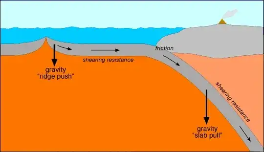

So, in answer to your question about the rate of tectonic movement, the factors that cause different rates, suggested on the webpage The Mechanism Causing Plate Tectonic Movements friction between the crust and mantle, and friction at collision zones play a major role, as illustrated below:
Image source
Specific mechanisms include (from the links above):
  • the thickness and density of the overlying crust
  • given that mountains have 'crustal roots' into the upper mantle (asthenosphere), they can act as obstacles for mantle flow
  • The heat energy within the mantle plume itself, as sources of radiogenic heat (e.g. uranium decay) are unevenly distributed.
