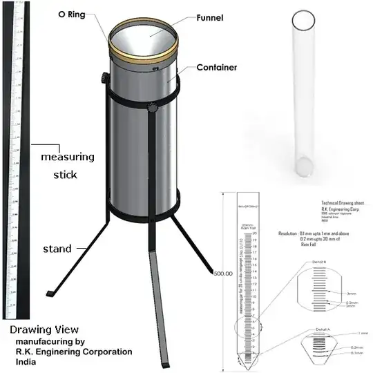

Weather stations measure the depth of rain that falls over a small, set area by setting an open topped cylinder of precise diameter in the open at a standard height above the ground and measuring how high the water rises within it over (usually) a 24 hour period. A standard 8"/203mm diameter is widely used for weather station rain gauges but is not required to give accurate measurements.
At its simplest the height of the water within the cylinder - which must be flat bottomed as well as the same diameter top to bottom is measured. Buckets, wheelbarrows that are wider at the open top than the bottom - or jars that are smaller at the top - are not suitable.
In practice, to make it easier and for greater accuracy a separate calibrated measuring cylinder of smaller diameter is used to measure what has collected. Each mm or inch marked on the measuring cylinder is equivalent to one mm or inch in the collecting cylinder.
(The use of a separate measuring cylinder - or automated measuring equipment - means the collecting container shape or size becomes irrelevant. Measurement is calibrated to the size of the opening - the top rim of brass in the example shown. Automated rain gauges are becoming more common.)

1Interesting. I'd expect the funnel to be deeper the tube to prevent rain splashing out. – chux - Reinstate Monica Dec 19 '23 at 04:36
1@chux-ReinstateMonica - I've done the duty myself a few times; the gauge I handled looked well optimised, including a sharpish inside edge to the precise brass rim, that would slice raindrops. The funnel starts a bit down from the rim. Seemed well designed for avoiding splash back out. – Ken Fabian Dec 20 '23 at 02:40

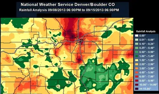

Properly designed rain gauges can give accurate results for a given location or point in space, but the problem is that it's hard to have enough of them packed densely enough in an area to give the level of detail that you might see in maps on news stations or weather websites. Models and extrapolation can fill in the gaps to a degree, but there could be a lot of error with it.
On the other hand, Doppler radar (a remote sensing tool) can measure the type and intensity of precipitation at various altitudes across an area with a radius of 100+ miles. By "scanning" periodically (it might miss very short bursts of precipitation!), this data can give a pretty good idea of what the accumulation was to a pretty fine level of spatial detail. It's the data used to create those animated maps showing the progress of a storm you might see on news channels or weather websites. Ground stations/rain gauges are then used to calibrate/verify the Doppler data; you don't need many of them for this purpose.
As others mentioned, a wheelbarrow will likely overestimate how much rain accumulates. But also, the models that use the Doppler data to create precipitation accumulation estimates won't be 100% perfect; averaged across a large area (or time), they're probably really good, but as you start to zoom in towards a small enough area or point, you could very well see some deviation (variance) from the true amount.
