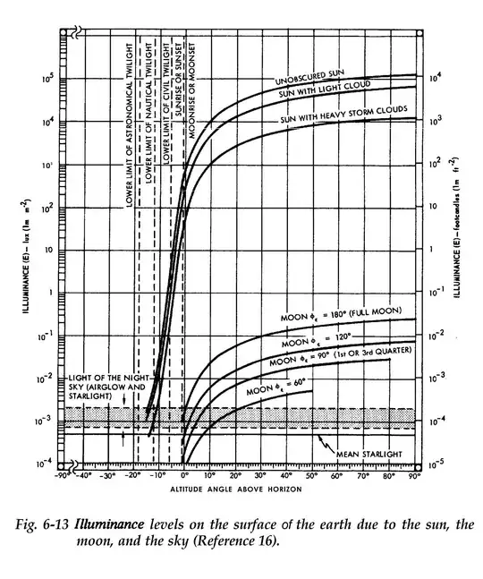

I am looking for a meteorological measure of daylight brightness/luminosity...but is there a measure that also captures the fact that particular regions of the world, far from the equator, have not only less daylight at some point during the year, but also less brightness, or luminosity, meaning that the sun is further down or up in the sky.
Consider the following -
Radio Corporation of America, 1968 (and in later years), RCA Electro-Optics Handbook. Section 6. Sources of Radiation, p.6-10ff, fig. 6-10, Atmospheric Transmittance.
Note: The image (below) is from a republication by RCA ca. 1974, p 74. Please note the original source reference, Bond and Henderson, 1963, given below.
illuminance, due to sun, moon, & sky, at surface of the earth.
  1. Bond, D.S. and Henderson, F.P., THE CONQUEST OF DARKNESS, AD 346297, Defense Documentation Center, Alexandria, Va., 1963.
