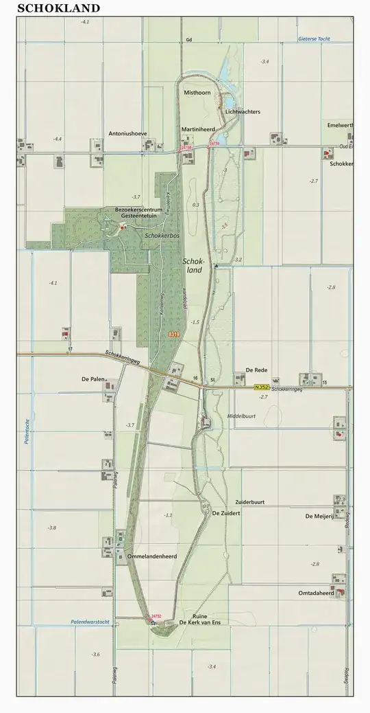

In The Netherlands, after the construction of the Noordoostpolder, the former islands of Schokland and Urk became hills with bases below sea level, although Urk is only partially surrounded by land, Schokland is entirely. Whereas the surrounding polder has an elevation of between -2.7 and -4.1 metre, the summit of the hill reaches as high as +0.7 metre according to the official topographic map (don't forget your high altitude gear), but it is apparently sinking and now only 0.0 metre above sea level. The former island is a UNESCO World Heritage Site and the primary (the only?) tourist attraction in the region (although there reportedly exists a nettle theme park somewhere in the region).
Schokland aerial photo
Schokland seen from above. Source: Wikimedia Commons.
There are also many terpen that are above sea level whereas their base is below sea level, but unlike Schokland and Urk, those are artificial hills, and if they count, the list of eligible hills in The Netherlands (in particular in Holland) becomes quite long.
Schokland topographic map
Schokland topographic map. Source: Wikimedia Commons / Topografische Dienst Kadaster. Heights in metre above the Amsterdam Ordnance Datum.

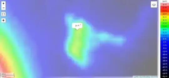

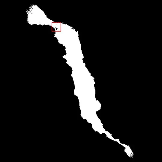

I had made a mask of below sea level pixels of the Badwater Basin in this answer. The mask have a few small areas of black pixels (i.e., above sea level pixels) completely surrounded by white pixels (below sea level):

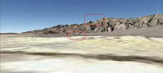

I checked on the site provided by @JeopardyTempest, there are indeed a few hills in the area. The largest one is a flat, ~30 m high hill just South of the Salt Creek interpretative trail:
Looking at it in Google Earth, I believe it is the hill (red ellipse, the red square is just a landmark for reference) pictured on this NPS photograph (public domain):
enter image description here (image Landsat / Copernicus)

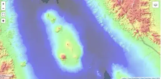

UPDATE: Ok I think I have found the best candidate, I'm amazed there actually is a true mountain completely surrounded by land below sea level, whose topographic prominence is therefore higher than its actual elevation. It's a volcano in Ethiopia, Ale Bagu: (https://www.peakbagger.com/peak.aspx?pid=77241), there is very limited information on wikipedia for such a unique mountain (https://en.wikipedia.org/wiki/Ale_Bagu) Ale Bagu Elevation 1013m, Topographic prominence 1066m

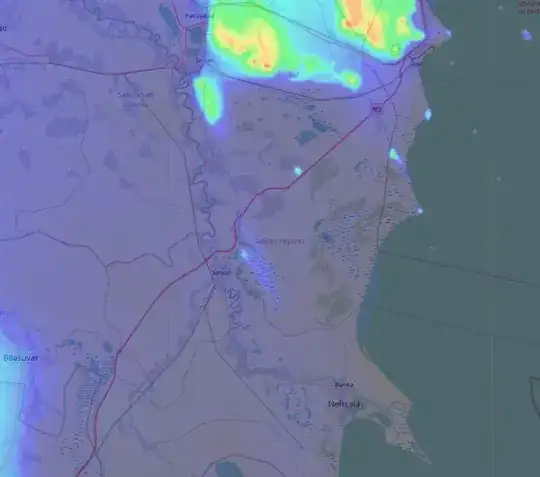

The Aghzibir mud volcano (Azeri Wikipedia) appears to rise 375 feet above sea level, with its base about 85 feet below sea level, for a prominence of about 460 feet or about 140 meters. It is located about 18 kilometers south of the city of Älät (Ələt).
There are apparently a significant number of mud volcanoes in Azerbaijan (further information in Azeri), and perhaps five or six of them of them rise in the region of the country that is otherwise below sea level. Aghzibir is the tallest of these, at least according to the data from topographic-map.com.

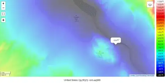

Death Valley in California, USA reaches a depth of 282 ft (86 m) below sea level. It contains a number of hills within the valley and mountains within 1 km of the valley.
To meet your qualification, here is Shore Line Butte (188 m) rising from land that is 124 ft below sea level. Note also Cinder Hill, whose "peak" is 29 m below sea level!
Map from topographic-map.com:
