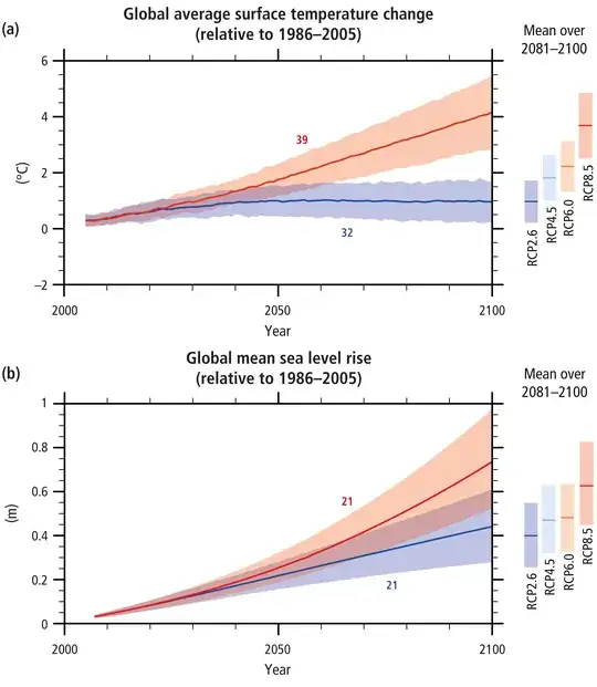

Error does accumulate in climate models out into the future -- that's why the forecasts include a range of possible results, that gets wider the further into the future you look.
See, for instance, this figure from the IPCC's Fifth Assessment Report, Summary for Policy Makers (SPM):
Global average surface temperature change (a) and global mean sea level rise
(b) from 2006 to 2100 as determined by multi-model simulations.
Each RCP is a pathway, depending on how much carbon we emit. Per Wikipedia, the number represents the expected radiative forcing, in watts per meter squared (W/m2) that can be expected in the year 2100.
The SPM explains what each RCP represents:
Representative Concentration Pathways, (RCPs) which are used for making projections based on these factors, describe four different 21st century pathways of GHG emissions and atmospheric concentrations, air pollutant emissions and land-use. The RCPs include a stringent mitigation scenario (RCP2.6), two intermediate scenarios (RCP4.5 and RCP6.0) and one scenario with very high GHG emissions (RCP8.5). Scenarios without additional efforts to constrain emissions ('baseline scenarios') lead to pathways ranging between RCP6.0 and RCP8.5 (Figure SPM.5.a). RCP2.6 is representative of a scenario that aims to keep global warming likely below 2°C above pre-industrial temperatures.
So if we stay on our current path, we can expect warming of 3 to 5.5 degrees, with sea level rise of 0.5 to 1 m.
