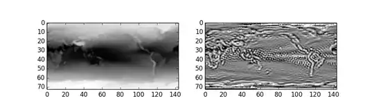

Here are some processed images that show the patterns:
historical median and local rank filter thereof
The image on the right is a local rank filter applied to the historical median at each grid point (left image).

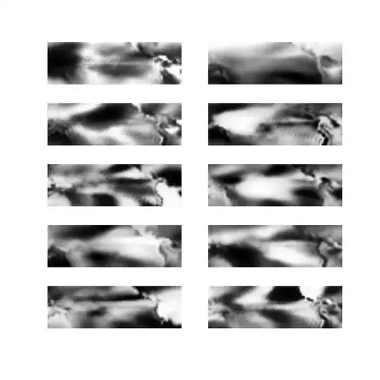

ICA components
10 ICA components of the date by grid point matrix for the Pacific region.
The patterns are strongest in the second row images and the left image on the third row. They appear to emanate from the coast of Chile NW towards the central pacific. The images are histogram equalized to improve contrast.

    A first though is that it may be an artefact because temperature measurements at sea are fairly sparse compared with data density on land. You should look at how and what data were assimilated into the reanalysis. – Peter Jansson Jul 13 '14 at 11:19
    It seems to be a data artifact. Have you tried to see if it shows up in any other databases? From the ocean side, maybe you could look at http://www.metoffice.gov.uk/hadobs/en4/ – arkaia Jul 14 '14 at 17:30
  • Isn't this just ENSO? http://en.wikipedia.org/wiki/El_Ni%C3%B1o – Dikran Marsupial Jul 17 '14 at 08:02
    ENSO is the El Nino Southern Oscillation. The oscillation referred to in the name is of the mean temperature across a large area of the Pacific, not these wave-like structures. – Andy Clifton Jul 30 '14 at 15:41
    How about artifact arising from your image processing filter? – Balinus Aug 08 '14 at 15:49
  • @Balinus That was my firs thought, but the same pattern turns up in a variety analyses. The pattern is faintly visible even if you just average the historical temperatures at each point without further enhancement. This makes me think it is really in the data. That does not mean it is physical. It could still be an artifact of the way the data was created, perhaps how it was discretized to the grid. This is what I am trying to determine. – Daniel Mahler Aug 08 '14 at 19:09
  • @aretxabaleta Thanks for the pointer. Cross checking against comparable datasets is the best test I can think of. – Daniel Mahler Aug 08 '14 at 19:21
    Interesting find. Have you tried contacting the authors of the reanalysis? – naught101 Oct 10 '14 at 04:30
    I just edited the question to make it clearer that this is a reanalysis dataset, not direct observations. Not sure if you were aware of that. Doesn't really affect the meat of the question though. Also, there are at least two lists of known problems with this dataset (here and here), but neither appear to include this problem. I'd say it's definitely worth contacting the authors and alerting them to this post - they might even be able to answer the question. – naught101 Oct 10 '14 at 05:28
    This is most likely an artifact of the processing. The other question you should go after is, if there isnt a newer dataset out there. This website hasnt been updated since 2002. In climate science this is really old. I would be very, very, very surprised, if there isn*t a newer dataset somewhere. – mace Oct 18 '14 at 14:42
  • The grid resolution in both the horizontal and vertical direction is around 280km, if we take the earth's circumference and half the earth's circumference as the domain length and height, respectively.Then, given that the wavelength is about 550km (as OP mentions), 280km is about the distance from crest to trough on those waves. This is a very strong indication of a data artifact. – Isopycnal Oscillation Aug 21 '15 at 18:48
It looks like a Gibbs oscillation, a basic feature of spectral analysis. In a spectral atmospheric model this means that near high orography artificial surface waves exist which may reflect in different variables. They are usually not considered to affect meteorology, however.
onlinelibrary.wiley.com/doi/10.1029/2010JC006927/full http://journals.ametsoc.org/doi/abs/10.1175/1520-0442%281994%29007%3C1169%3AROTGOI%3E2.0.CO%3B2
This is from Bacmeister, Julio T. "Weather Prediction Models." Climate Change Modeling Methodology. Springer New York, 2012. 89-114.
  • 4,051
  • 48
kakk11
  • 338
    Citation needed. – milancurcic Aug 26 '15 at 15:00
  • Yes, of course. This paper says that Gibbs-like phenomena is a problem in NCEP (http://onlinelibrary.wiley.com/doi/10.1029/2010JC006927/full) and this is description of the phenomena in atmospheric models http://journals.ametsoc.org/doi/abs/10.1175/1520-0442%281994%29007%3C1169%3AROTGOI%3E2.0.CO%3B2 Do not take these references as a "proof" but just an explanation of why I think the images in original question are related to Gibbs phenomena. – kakk11 Aug 26 '15 at 16:20
  • @kakk11 Welcome to the site! Could you please add those references into your answer, so that everything is in one place? – gerrit Aug 26 '15 at 16:27
