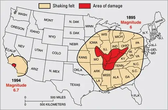

The question doesn't really make sense.
The Richter and other seismic magnitude scales are measures of how much energy was released by an earthquake or how much work it did. An earthquake doesn't "feel like" any particular magnitude at any given point; rather, magnitude is an inherent attribute of the earthquake itself.
"Feels like" is measured on seismic intensity scales such as the Mercalli scale. These measure the peak acceleration or velocity at a given point, or the damage done by the earthquake. Intensity is influenced by many things, such as the depth of the earthquake, the distance to the ruptured section of the fault, and the local surface material.
Translating between the two is difficult, and requires knowing the detailed geology of the area involved. The picture below is a USGS map of two earthquakes of comparable magnitude, the 1994 Northridge earthquake and an 1895 earthquake on the New Madrid Seismic Zone. In both cases, the outer zone is an intensity of Mercalli II or above, while the inner zone is an intensity of Mercalli VI or above.
A map of the United States, showing the effects of two earthquakes.  The 1994 Northridge earthquake affected an area consisting mostly of southern California, with a small damage area.  The 1895 New Madrid earthquake affected most of the eastern United States, with a damage area covering large parts of Tennessee, Kentucky, Ohio, Indiana, Illinois, and Missouri.
