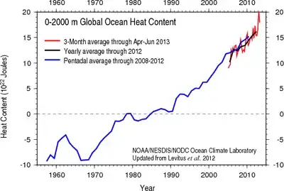

I'm interested in this problem because I'm interested in obtaining a rough estimate of the average temperature increase of the sea given a net radiative forcing of 0.6 W/m^2.
But in order to obtain an estimate, I need to know the volume of the ocean between 0-2000m. I'm also interested in knowing the volume of the ocean between any other two arbitrary layers of the ocean (0-1000m, 1000-2000m, 0-4000m, etc..)
