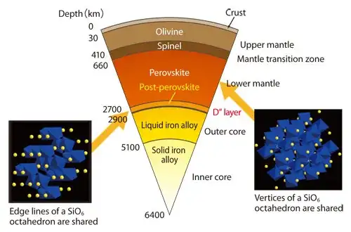

In the case of Earth, there are several progressively denser phases that do not mix. The biggest step in the density gradient is when the rock phases (olivine, spinel, perovskites, and ferropericlase which is not shown in the illustration below) give way to the much denser core. In the illustration below, this boundary is where the bottom part of the rocky mantle, the D" layer, meets the predominantly iron core.
enter image description hereSource
One major difference between the interior of Earth and the oil-water combination in the first picture is that much of Earth's interior is solid, so it takes a lot of heat and pressure -- both generated by gravity -- to make the materials yield and flow to their equilibrium positions. The same is true of other predominantly solid celestial bodies, so only relatively large and massive ones have enough gravitational power to enable separation of different density phases. Planetary scientists call this process differentiation.

  • Minor correction: "The biggest steo in the density grad ent is when the rock phases (olivine, spinel, perovskites) give way to the much denser core."
    Olivine and spinel are not stable near the earth's core. In addition to perovskite, ferropericlase is thought to be an abundant phase in the lower mantle.
    – g.z. Jan 11 '21 at 18:53
  • I knew that, but the illustration unfortunately does not show the ferropericlase, which causes an inconsistency if I were to mention that phase. Can you offer a solution? – Oscar Lanzi Jan 11 '21 at 18:58
