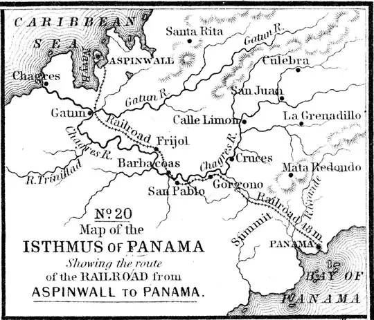

It's important to note that major man-made navigational canals often are often routed so that only a smaller bit of new waterways is dug; they are typically made by connecting existing waterways with smaller cut\cuts across higher mountainous areas, plus shortcuts in any place where straightening the route saves significantly.
It seems hard to find detailed construction maps (unfortunate!) But here is a map of the area before the canal was made from the USF historic maps archive:
Comparing that to the Wikipedia map of the Canal shows two main areas of new waterway creation
However, the largest creation on the map appears to be the expanse of Gatun Lake created by damming the river to create a wider channel (with other connected benefits like power and water storage). Damming rivers is of course a widespread practice around the world for purposes including water regulation, power generation and agriculture.

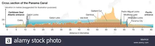

Since the Panama Canal isn't directly connected to the ocean and the water is overwhelmingly above the ocean sea surface, there was no reduction in sea level. See diagram:

    I don't see why the fact that the canal is above sea level, or the fact that it's not directly connected to the ocean would make any difference for this question - that water had to come from somewhere. One could empty the ocean by pumping it into a sufficiently large above-ground tank. Whether we can measure the drop in sea level or not, you can't fill the Panama Canal "for free" without taking that water from somewhere else, regardless of the canal's height or connection to the ocean. – Nuclear Hoagie Nov 16 '20 at 20:45
