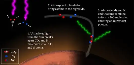

The above facts indicate that there is not much material to recycle in the chain presented in the image below:
And in order to keep the Dynamic Equilibrium between the gases in the Martian atmosphere there must be a reaction of NO becoming back to NO2, that occurs at the same time in some other part of the planet, such as this one:

The Martian nightglow comes from molecules in the atmosphere that react with solar radiation, carry it over to the night side, and give off the energy they gained as ultraviolet light as they free-form stable compounds. From https://www.nasa.gov/press-release/goddard/2020/mars-nightglow:
The diagram explains the cause of Mars’ glowing nightside atmosphere. On Mars’ dayside, molecules are torn apart by energetic solar photons. Global circulation patterns carry the atomic fragments to the nightside, where downward winds increase the reaction rate for the atoms to reform molecules. The downwards winds occur near the poles at some seasons and in the equatorial regions at others. The new molecules hold extra energy which they emit as ultraviolet light. Credits: NASA/MAVEN/Goddard Space Flight Center/CU/LASP
The Martian nightglow has been used to trace atmospheric circulation on Mars.
