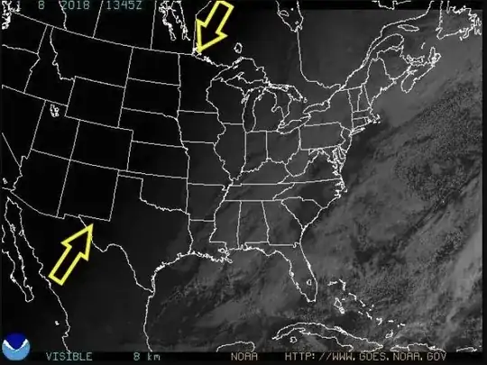

I was wondering is the sunlight reaching from the general direction east? I came to this conclusion because the image is so dark on the west side however I am not 100% sure.

1This is a visible image display and I was wondering at this time the sunlight was reaching the U.S. from the general direction of west or east? I was thinking east because it is bright on the east side and dark on the west side. – Michael Guest Feb 16 '20 at 20:52

Yes. The time stamp says that the image is taken at 13:45Z, which means the sun is overhead in the Eastern Atlantic (12:45 PM local time in Cabo Verde and the Azores). In Winnepeg, near the upper arrow, it is 7:45 AM and still in darkness.
Being winter in the NH, places that are more southerly like Louisiana and east Texas in the US have light while places at the same longitude further north do not.
You can tell that the image is taken in winter from the south-west to north-east slope of the terminator (i.e. the line separating the light and dark areas, see discussion here).
