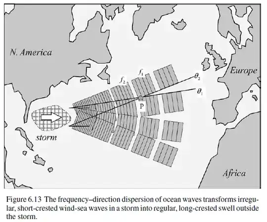

Ocean waves (and also in mediterranean type seas and larger lakes, but on a smaller scale) are generated by two processes:
  • locally generated waves ("wind waves"), which follow the direction of the wind;
  • waves generated further out in the sea (i.e. "swell waves"), which do not necessarily follow the direction of the wind.
During the night, you are probably seeing swell waves. Of course, some wave energy is generated also in the opposite direction by the wind blowing offshore, but one can only "see" these waves further out in the sea if the wind is strong enough (see the definition of fetch).
Also check the Figure [1] below for clarification on how swell is generated (the longer period wave energy travels faster than the energy of the shorter period waves, so the initial "random" wave field disintegrates into regular swell).
