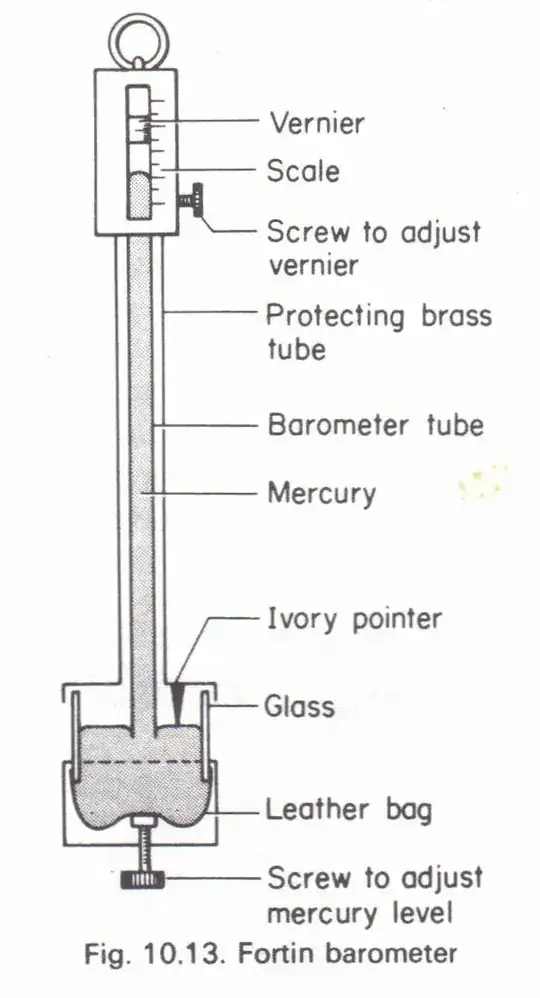

The diagram below illustrates the features of a Fortin barometer.
Immediately prior to taking a pressure reading, the air temperature needs to be measured so the reading from the barometer can be corrected. It also needs to be measured as soon as possible, prior to reading the pressure so the barometer is not affect by the body temperature of the person taking the measurement.
The height of the mercury cistern in the barometer is then adjusted to just touch the ivory pointer.The floating vernier scale is then lowered to just touch the meniscus of the mercury in the tube.
The scale on the side of the barometer gives the main part of the pressure reading and the vernier gives the decimal fraction.
Referring back to the question, the barometer doesn't float, the vernier scale is the item that "floats" by being adjustable.

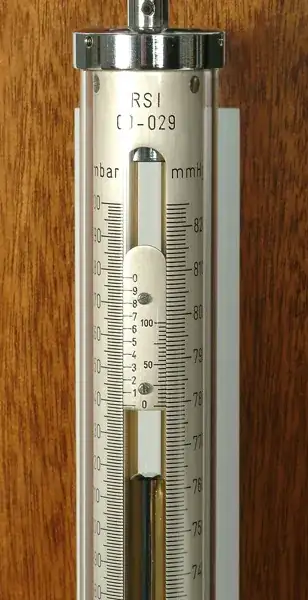

The picture below illustrates the position of the vernier scale when taking a reading from a Fortin barometer.
