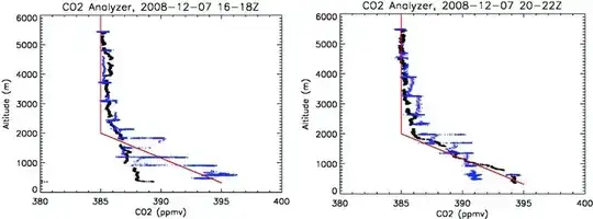

According to this exam solution from ucmerced.edu
The residence time of air in the stratosphere is 1-2 years, so that CO2 concentrations in the stratosphere represent those found in the troposphere 1-2 years before. The growth rate of CO2 in the troposphere is 1-2 ppmv yr-1, and the time lag for transfer of air from the troposphere to the stratosphere thus results in a 1-2 ppmv difference in concentrations between the two reservoirs.
The charts in this question indicate that CO2 concentration decreases with altitude: enter image description here Wikipedia says
In 1992, emissions of CO2 from aircraft were estimated at around two percent of all such anthropogenic emissions, and that year the atmospheric concentration of CO2 attributable to aviation was around one percent of the total anthropogenic increase since the industrial revolution, having accumulated largely over just the last 50 years.
So it seems that the altitude at which the GHGs are emitted does not make much difference.
