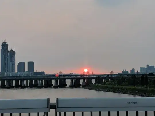

Today (July 5th, 2019 just before 8 pm KST), along the Han River in Seoul, the surface of the sun could be viewed with my naked eye (no protection needed), and this was safe on the eyes. It appeared much redder and it wasn't bright at all. Also, there was no visible "fog" that blocked the view of the sun in my vicinity.
I am curious about the conditions needed to create this phenomenon A possible use-case of an answer could mean the possibility to better predict when I should go view the sunset over the Han River in Seoul. It's beautiful!

Here is a photo that can help show the conditions that were present at the time. Please note that the sun appears much brighter in this picture than it was in-person. The sun was actually really dull red. As you can see, there were clouds, but I am trying to find maps that show the cloud coverage around that time, as I don't believe it was thick.

  • @Friddy while the picture looks "heavily" cloudy, it was more clear than it looks. I have seen instances where I could look at the sun directly due to cloud cover and other highly visible material, but that was less apparent during this time. There appeared to be little in the way in my near vicinity. – Christopher Rucinski Jul 06 '19 at 06:06

I am familiar with this phenomenon. In London, in winter 1947, I remember being able to see sunspots with the naked eye. The sun was very orange, like the one in your photo. The reason I was able to see sunspots was,of course, that the London sky was polluted with fumes and the winter sun was low on the horizon, so the rays had a greater thickness of atmosphere to penetrate. Much of the short wavelengths were filtered out, while the longer, redder wavelengths were able to get through. Much the same thing seems to have happened when you took this photograph of Seoul. It is common knowledge that red wavelengths penetrate foggy or hazy atmospheric conditions better than shorter wavelengths.

  • I do highly believe that there is a 3rd condition that needs to be met, and that condition is particles in the air. Due to the curvature of the Earth, the effects of fog, haze, and distant clouds along the 400km+ line-of-sight path. Again, the clouds nearby were much thinner than they appear in the picture. I looked at some weather 400km to the west-north-west of Seoul and found that high clouds were present and very possible in the line of sight. With the Incheon, Korea and Seoul weather, it's possible these all added up to show this dull red sun?? – Christopher Rucinski Jul 06 '19 at 06:27
