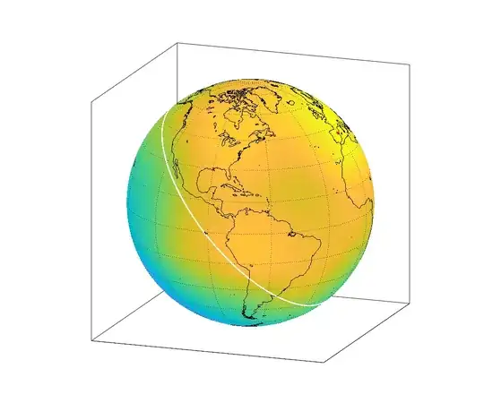

I wrote a little Matlab script to estimate this approximatively. Here is the result: colour denotes the total land area inside the hemisphere centred on a particular surface point. The red point is the maximum. enter image description here
This gives me a maximum for the hemisphere centred on 1.7582°W longitude and 40.7692°N latitude, roughly in Guadalajara, Spain. If I calculated right this is 81% of all land, with 23.37% land area on the hemisphere (and 5.83% on the other hemisphere). So the answer to the question is no, there is no hemisphere with more land than ocean. There isn't even one with more than half land.

(Updated 2019-06-23 with higher resolution estimation, which moved the point south a bit.)

  • You 43°20′N 1°06′W point is a bit south of the point designated in the wikipedia article on the land and water hemispheres, 47°13′N 1°32′W. That point appears to be based on 1891 maps and was determined without the aid of computers. – David Hammen Jun 22 '19 at 12:53
    +1 for the interesting process and answer, but in order to answer the question the answer should include which percent of that hemisphere is actually land (that is, the area of 81% of all land divided by the area of an hemisphere). – Pere Jun 22 '19 at 13:33
  • Added the answer and ran my model at a higher resolution. The centre is still in Spain rather than France. I think one can quibble a fair bit about the correct way of doing this: I count large lakes as not-land, for example. – Anders Sandberg Jun 23 '19 at 11:30
