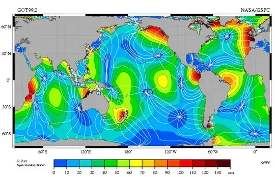

First of all, tides are not as simple as the "two-bulge" simplification. In reality, the diagram shown is misleading. The two bulges appear assuming an ocean of constant depth covers the entire surface of Earth. Clearly that is not the case and in the diagram you can see the continents. Considering the different sizes of the basins and the distinct frictional characteristics in each location, the resulting tidal effect is much more complex. The difference in phase and amplitude is shown here and it clearly shows that the the tide varies for the same longitude. That wouldn't be the case in the simple explanation above. M2 tide Source Wikipedia.
Looking at this tidal animation from TPXO is also illustrative. Tidal animation
The simple "two-buldge" explanation would result in a pure two peak daily tide. That is certainly not the case in places like the Gulf of Mexico.

In reality, the tides instead of running east to west as Earth rotates, tidal waves propagate around in circles around islands, and certain points in the sea, called tidal nodes or amphidromic points. These nodes can be seen in the first figure from this answer.
Thus, the tidal patterns in the ocean are a set of rotating standing waves. These waves have periods that represent the natural resonance periods of the ocean basins. These waves can be considered modes of "vibration" and can be decomposed using a Fourier decomposition. That is the source of the different tidal constituents that are used currently for tidal prediction.
