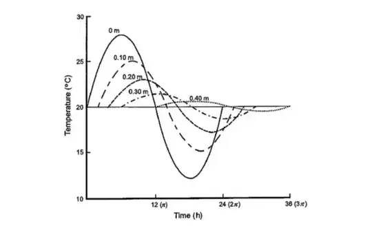

This figure shows a heat wave in the soil
(figure from Soil Temperature at ScienceDirect)
As you can see, the plot shows that there was a peak in temperature of about 27°C at the surface (0m) at time t=6h, but that peak in temperature slowly diffused downwards, such that at a depth of 0.2 m, the peak happened at time t=8h reaching only about 23°C, and at a depth of 0.4 m it arrived even later, at about t=18h and reached only 21°C.
