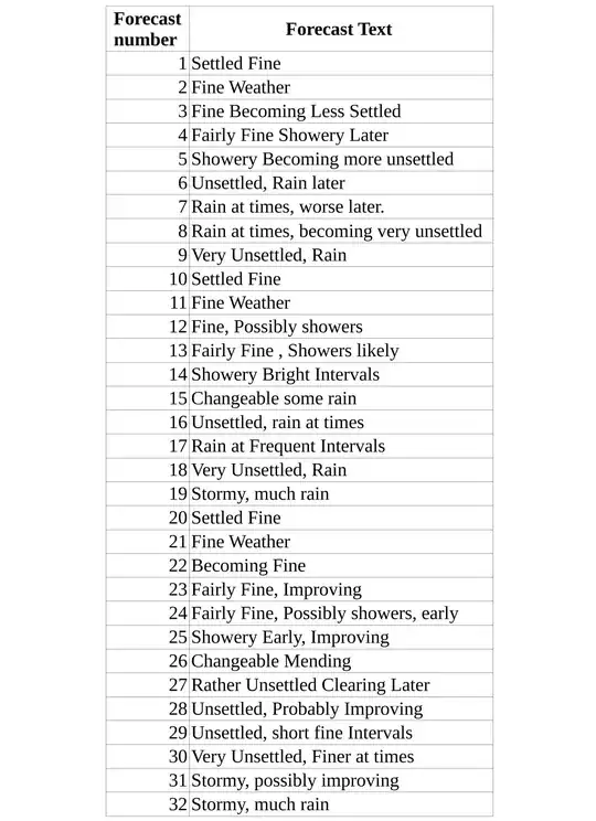

  1. Look up for the forecast from the following table:
This was made for the UK, and many people have developed modified version to work in other areas. You will find many implementations online with downloadable code, as this one in javascript, or this one in C for Arduino UNO, an explanation of this Arduino UNO implementation can be found here.
