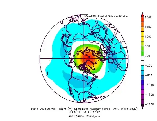

Now that the reanalysis data is available from January 2019 I want to add some visuals for the Dec-2018/Jan 2019 polar vortex split and ongoing cold wave.
The OP's link, plus this SlashGear article on the polar vortex split provide GEFS and GFS forecast data, pointing to a three-way split of the polar vortex. I went through reanalysis data from the period of Dec 18th 2018 through Jan 30th 2019 and there appears to be two separate candidate dates for a three-way split of the stratospheric polar vortex; it really depends on whether one considers the small vortex over the North Pacific as one of the split vortices or not on Jan 5th 2019. The 5th January event is the one that most closely resembles that GFS forecast data. In saying this, the reanalysis data is averaged over a full day as opposed to the single point in time of the GFS data. In the geopotential height anomaly there is a clear three way split but one must remember that the anomalies are calculated vis-a-vis the climatological period 1981-2010. Either way this will require more detailed research before the three-way split is confirmed or not.
enter image description here enter image description here enter image description here enter image description here Finally from the reanalysis data it appears that, in contrast to the 2018 event, this year's event points to significant instability in the dynamics of the polar vortex. There are clear suggestions that the polar vortex is breaking and reforming again over short time scales, which is interesting.
