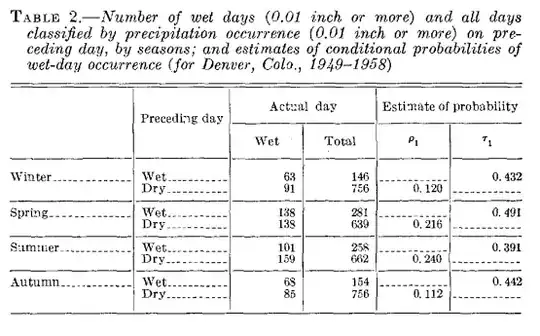

However, with a little searching I did at least find A Markov Chain Model for the Probability of Precipitation Occurrence in Intervals of Various Length by James E. Caskey, Jr., which did at least have a table along the lines you've asked... for Denver, Colorado between 1949-1958, using 0.01" (0.254 mm) as the condition:
For those struggling to figure the values out, in this table when $\rho_1$ is similar to $r_1$, utility of precipitation persistence is low.

  • @Universal_learner I can't say I'm quite sure what you're saying here... but yes, over large data sets, the two percentages would become more and more equal if there is no forecast skill for persistence (the "random noise" contribution/confidence interval shrinks). But because each day isn't entirely independent to the next, there is some skill in persistence (in fact that winter data suggests it's about 3.5 times as likely to precipitate there the day after a wet day compared to a dry one, pretty remarkable!) – JeopardyTempest Oct 15 '18 at 17:23
