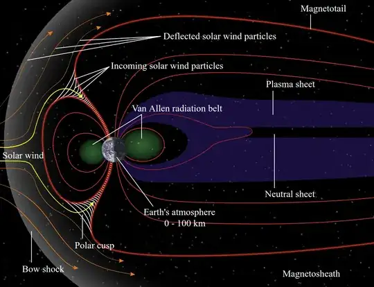

This figure from Wikipedia's Magnetosphere page will illustrate the problem:
As you can see, most of the charged particles are deflected away from Earth (orange lines), but a fraction of them gets funneled towards the poles through the so called "polar cusps" (yellow lines), that's why auroras (a.k.a. northern lights) happen around the poles. As you can see, the size of the polar cusps "funnels" is comparable to the size of the Earth, therefore giving rise to the discussion if the magnetic field increases or decreases the amount of charged particles that hit the atmosphere: If the funnels are smaller than the Earth the magnetic field would decrease the amount of particles hitting the Earth, but if the funnels are larger the particles hitting us would increase.
These charged particles are usually cited as relevant due to two reasons:
  1. They are harmful to life by increasing the dose of ionizing radiation that reach the surface. Such radiation in turn generates mutations in the DNA.
  2. They can hit molecules in the atmosphere fast enough to send them to outer space, leading to atmospheric escape and the thinning of our beloved atmosphere.
The first point is only partially true, because the atmosphere itself is an extraordinary shield against cosmic and solar radiation. Therefore, even in the eventual shutdown of Earth's magnetic field, not much radiation would reach the surface anyway. That's perhaps one of the reasons why nobody has been able to link magnetic reversals to mass extinctions. More on that is discussed in this question.
The second point is also questionable, because although the magnetic field does redirect the charged particles to the poles, it is unclear if the amount of particles currently hitting polar areas is more or less than the amount that would hit the entire Earth in the absence of a magnetic field. Notably, atmospheric escape would be equally bad if it happen distributed over the globe or if it is concentrated at the poles.

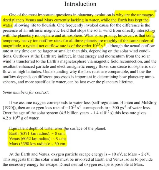

Dr. Robert Strangeway kindly shared with me the poster he presented at AGU fall meeting 2017, the one I cited in the question based in the abstract only. I've included below some of the key parts of the poster with some text highlight added by me.
He focus on Oxygen loss as a proxy of water loss. And the answer to my question that can be derived from this work I think would be:
Currently Earth intrinsic magnetic field doesn't seem to be more efficient in preventing Oxygen loss than the induced magnetic fields of Venus and Mars. However, while is relatively easy to model the effects of intrinsic magnetic fields in the past of Venus and Mars (when solar wind was stronger), we do not have the knowledge to do such modeling for the case of the Earth's intrinsic magnetic field. Therefore, we don't know if such intrinsic magnetic field was or not an advantage in the past.
